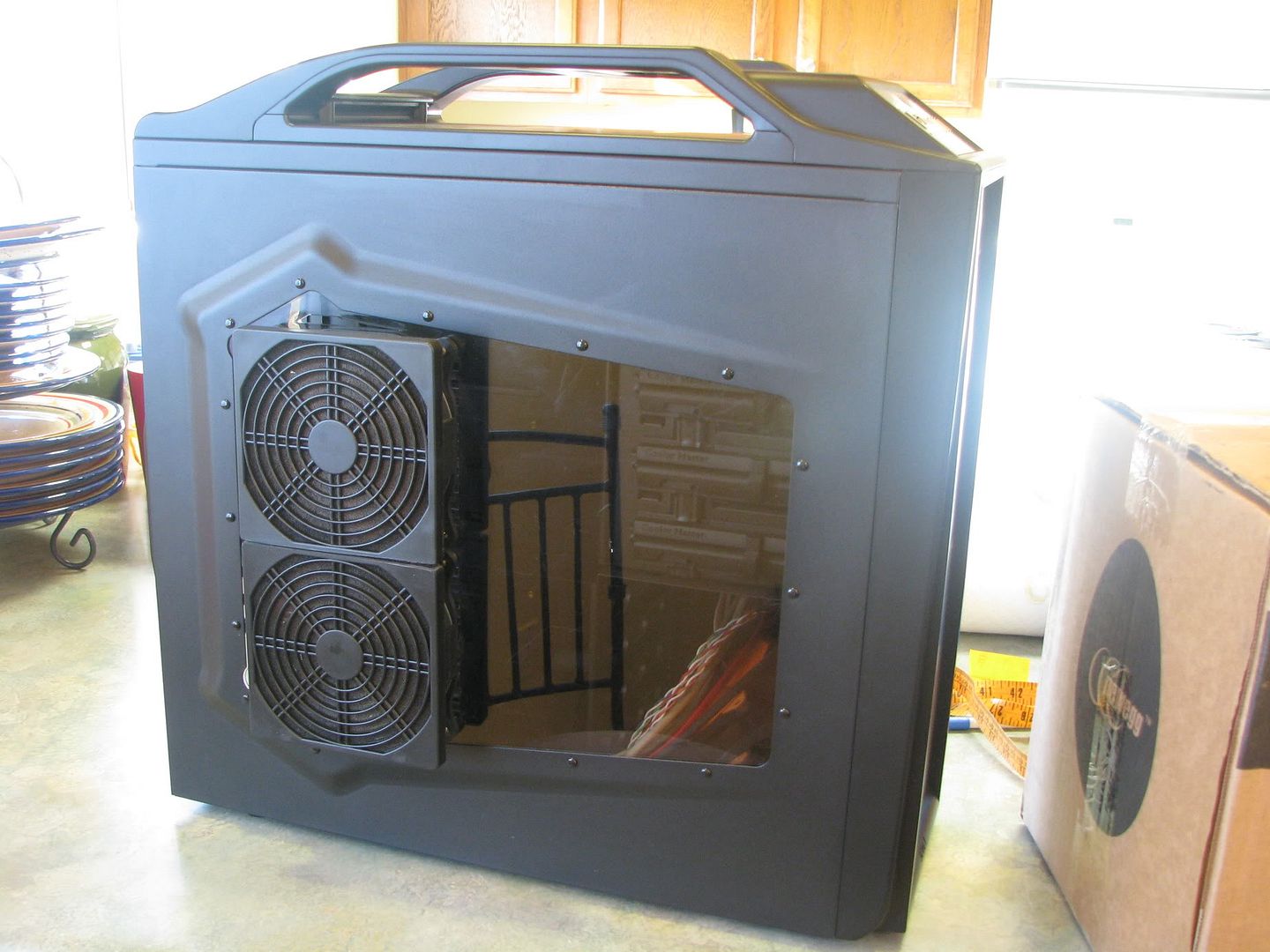

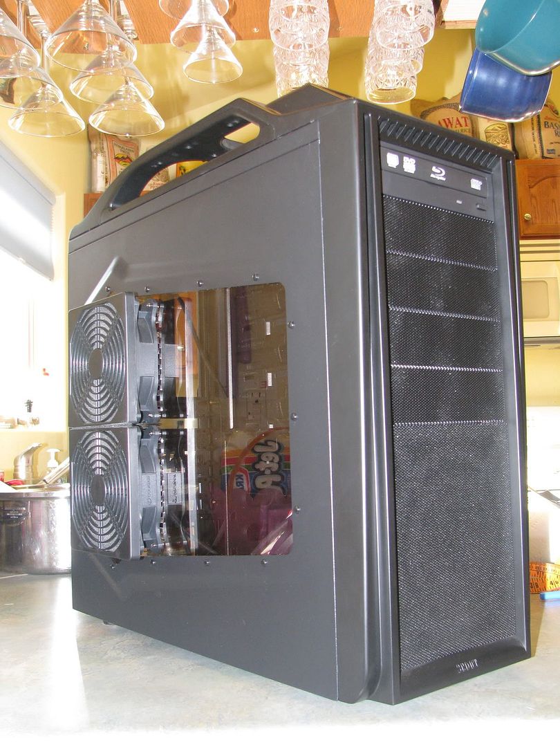

    Currently I have been sporting the CoolerMaster Storm Scout case, it features a tinted side view window, several 120mm/140mm fan slots.. as well as a good width of room behind the motherboard for routing any wires I may have to hide. It also features a large handle that is reinforced with steel connected direcly to the case, VERY sturdy, and makes moving the computer case an absolute breeze using a single hand.
    I went ahead and began removing all of my PC components, as I had my computer running in the office for several years with only a bare minmum of cleaning. If you are going to open up a used case and begin modding/managing it, this is your chance to finally pull all the components out and start cleaning things!

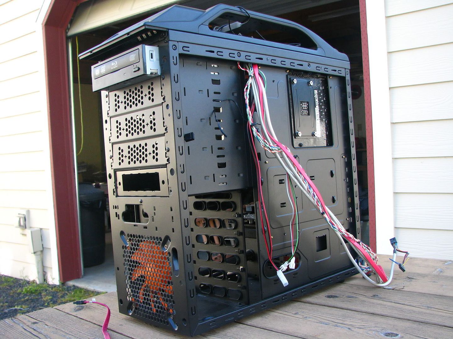

    In these two pictures, you can see I have removed all side panels, the front panel, and have begun removing the various hard drives and misc wires hanging around. Every piece I pull out, I wipe down with a damp paper towel and simple green (Sprayed directly on the paper towel, NOT on the component!)
    After removing ALL PC components, and cleaning up all the extra dust from the fan intakes, I am left with a clean project:
    If you notice the front panel - I modded the panel itself to accept two fans on the front, and had to reverse the entire tinted plexiglass in its mount to prevent a whistling noise from installing high static pressure fans. If you own this particular case and are interested in anything I have done, feel free to PM me with any inquiries!

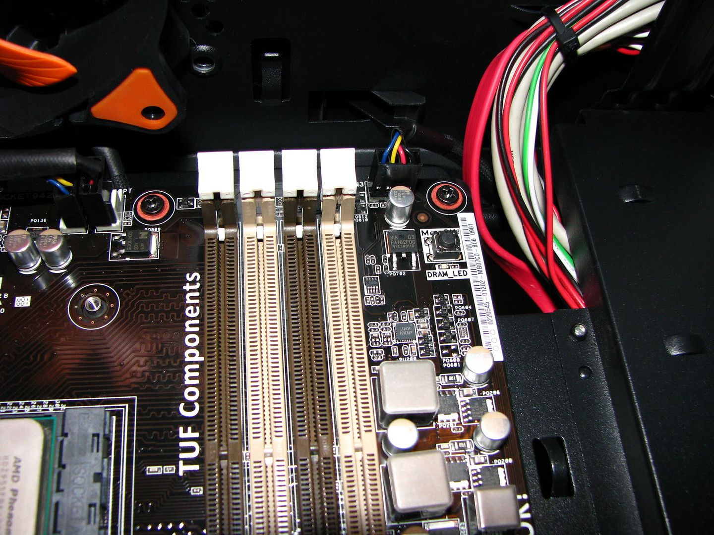

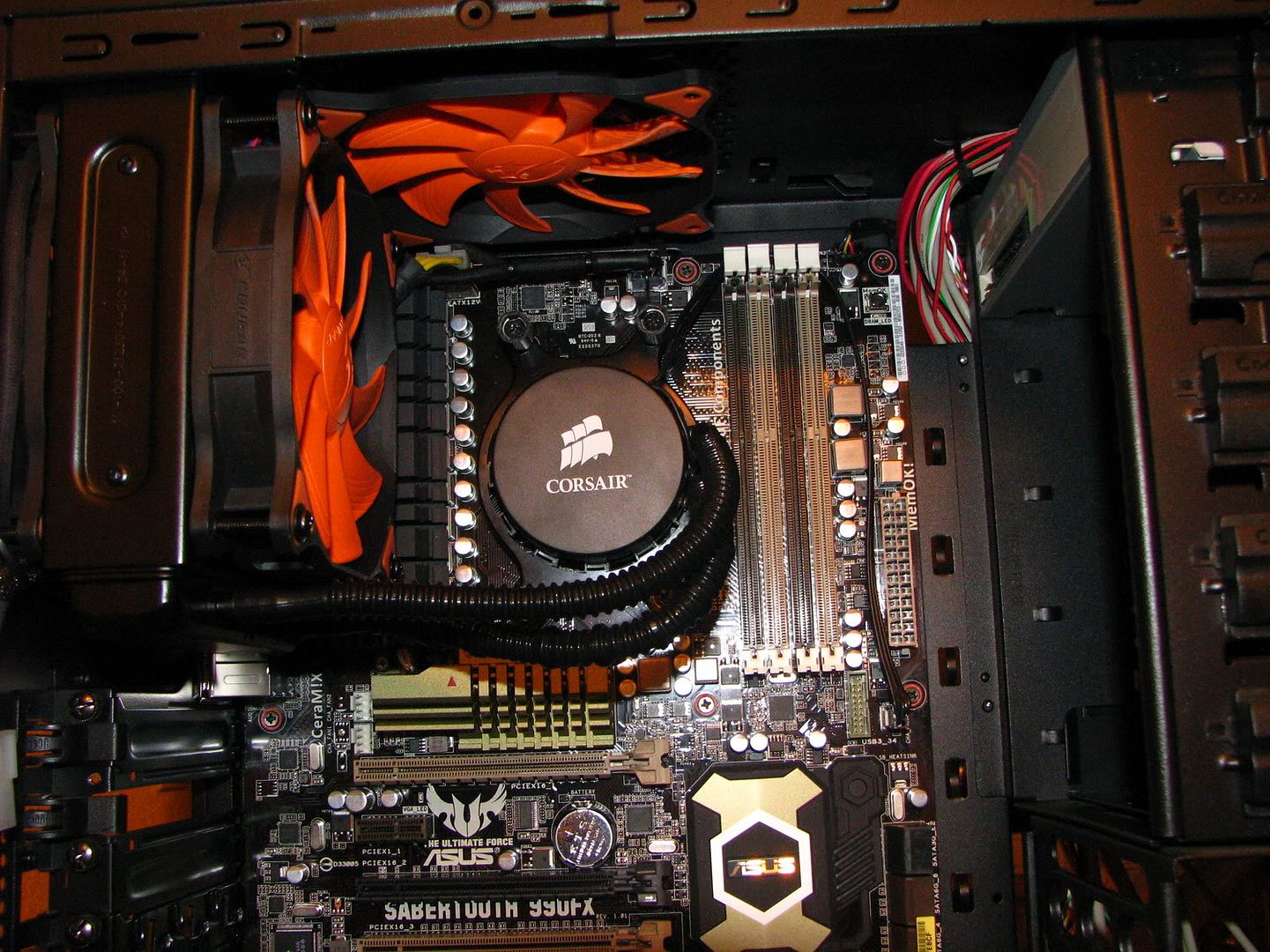

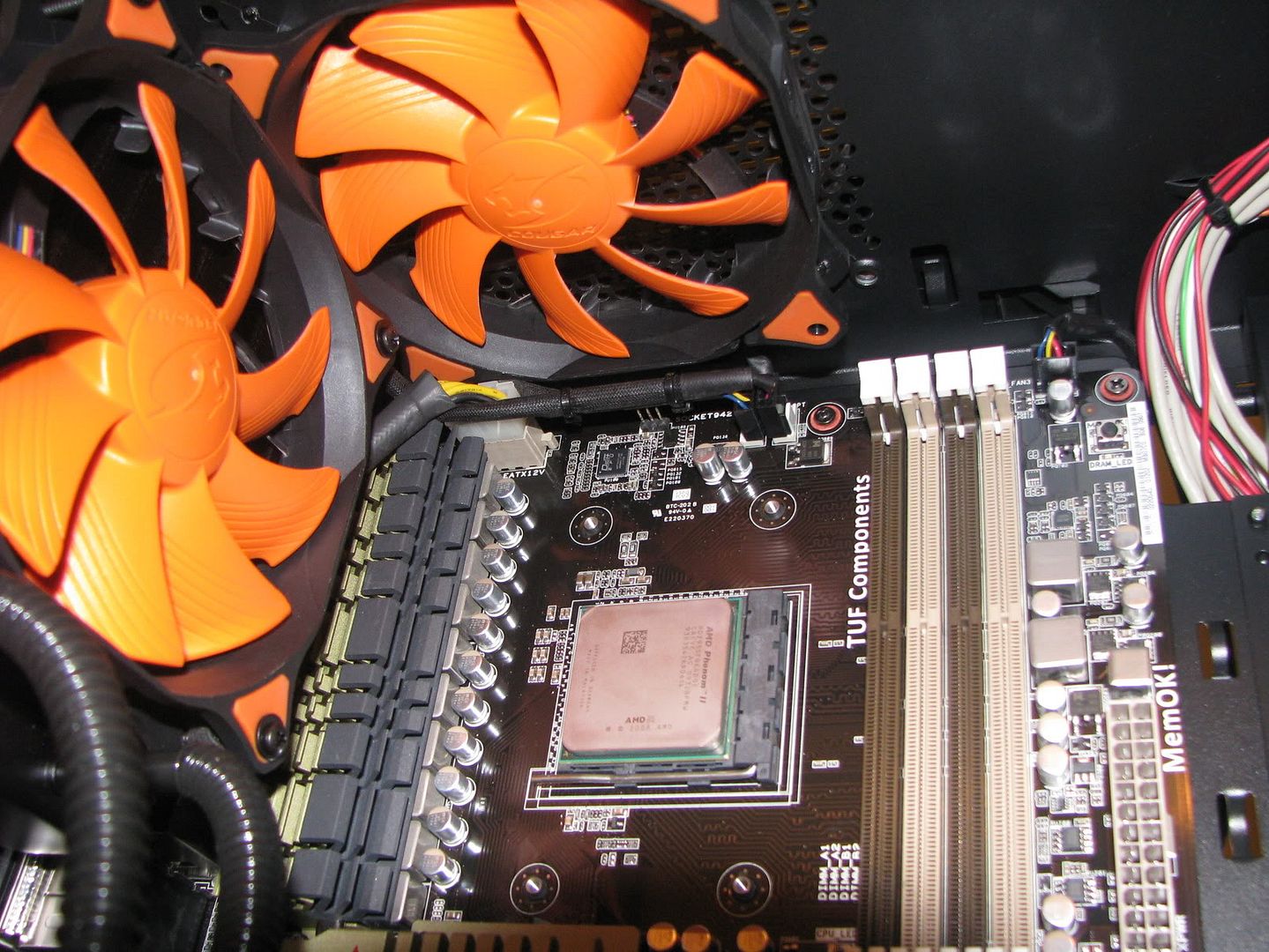

    For the first session of cable management, I had 2x 4 pin PWM fan plugs at the top of my motherboard, and each Cougar fan has about a full 16" of wire length, which is fantastic for a tower/super tower build.. but a slight bit excessive for a standard mid tower. To suck up extra length, the goal is to wing the wire around the fan itself before you mount it, and use Zip Ties in the empte holes of the fan to hold the wwire in place. Rotate the fan while doing this until you have it mounted, and only have a few inches of slack left to make it to your 3/4motherboard pin.
    In this picture, you can see 2x 4pin PWM fan plugs, and the 8 pin motherboard Molex. I ziptied the two 4 pin's together after shortening their length by 'winding' them around the fan, while the 8 pin molex extension I ran underneath each of the cougar fans and ziptied it to keep it up off the motherboard.
    Success! Completely hidden from view as allowed, and promotes fantastic air flow between my Corsair H70, and the top mounted single Cougar.

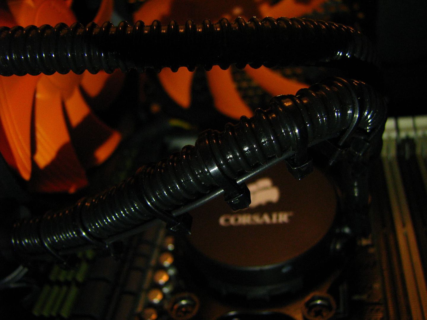

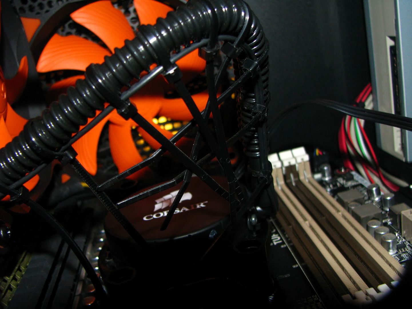

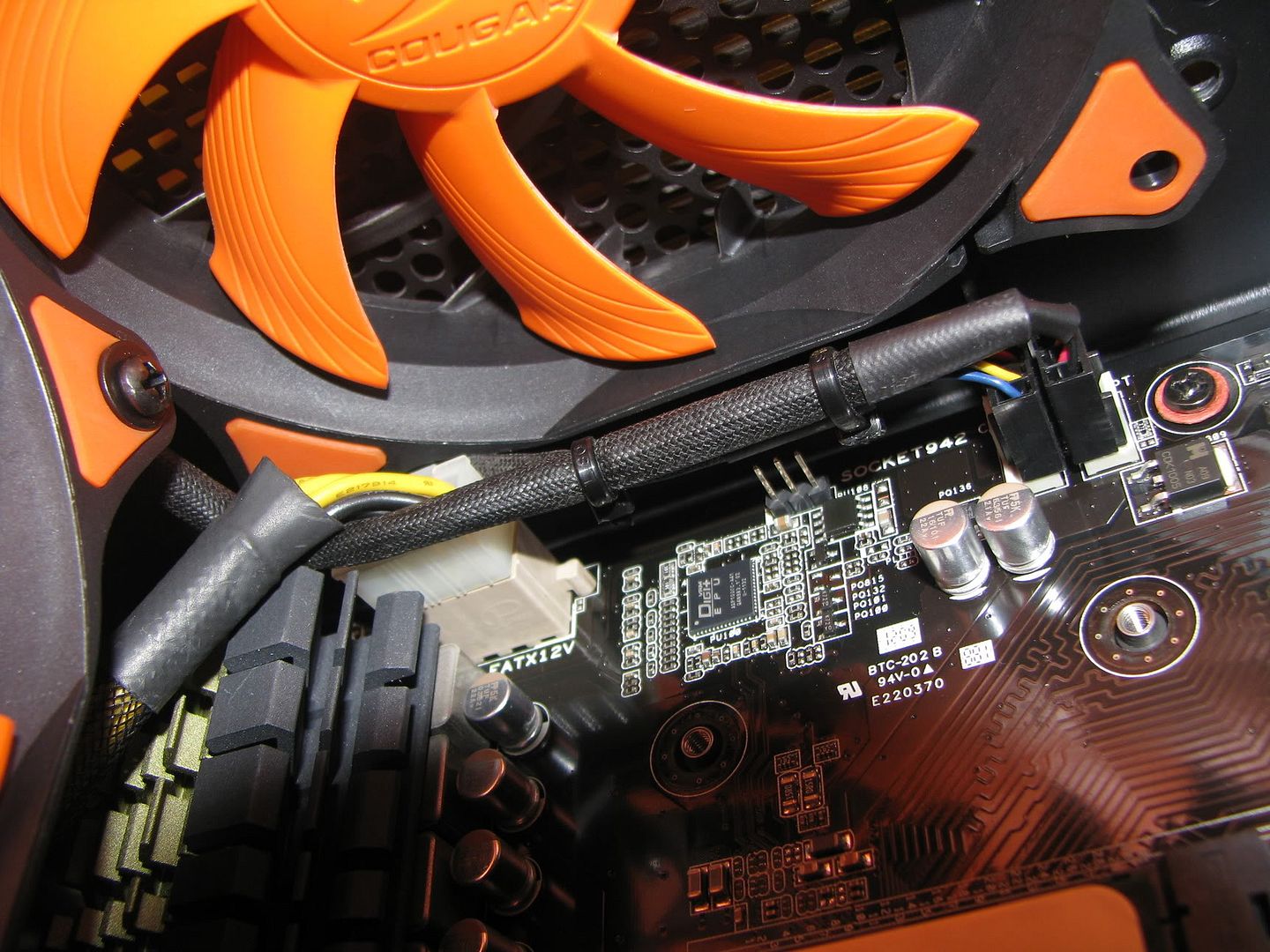

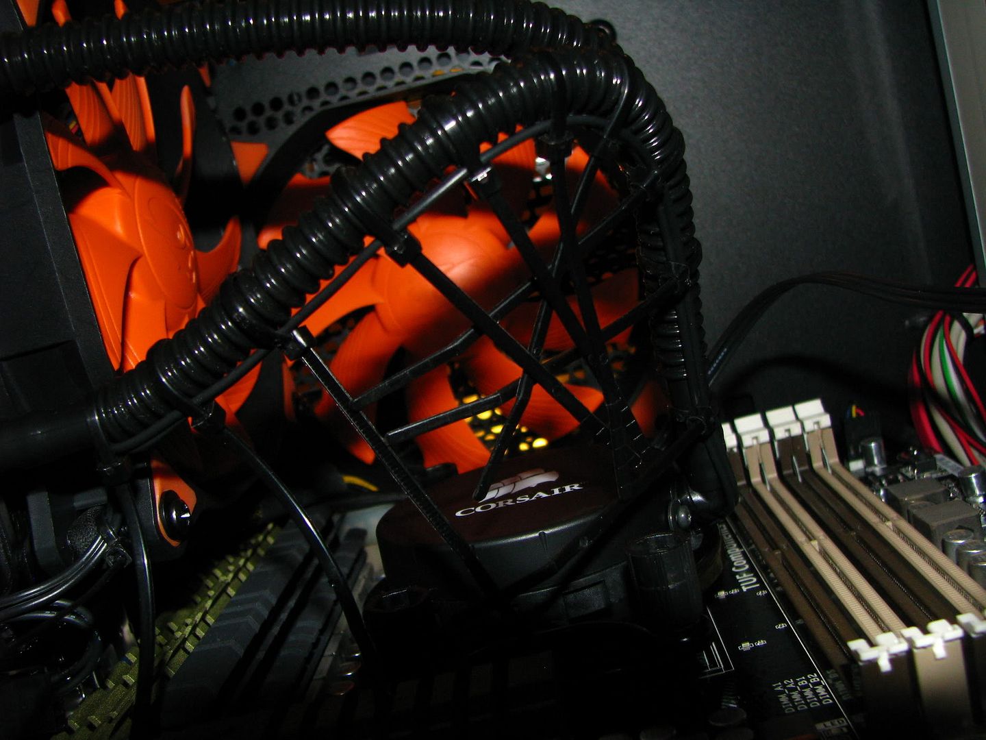

    After figuring out the length needed to get to the corner 4 pin PWM plug, I pushed the 16" length of cable from the fan, behidn the motherboard tray, and rerouted it back through to the front right before the hard drive bay. Don't mind the mess of cables to the upper right, those are the standard case cables - which always make a mess.
    After spending about 10 minutes getting my H70 mounted, I determined I did not need the 2x 4 pin PWM plugs that is has available, I wanted completel control of my fan setup through the motherboard itself.. so my only option was to find a way to completely hide the cable itself.
    This may look liek a mess, but with a very dilligent use of many zip ties, and using the same color as the tubing wrap, I was able to route the entire extra cable along the water tube. And after clipping the zip ties, arranging it so the stubs were behidn the cable, it looks like this:
    Success, Again! Looks completely stock, no visible wires - and promotes fantastic airflow throughout the immediate region. The absolute goal of good cable management is to make it look clean, and to let any air to flow where its path is, without being disturbed by the cables.

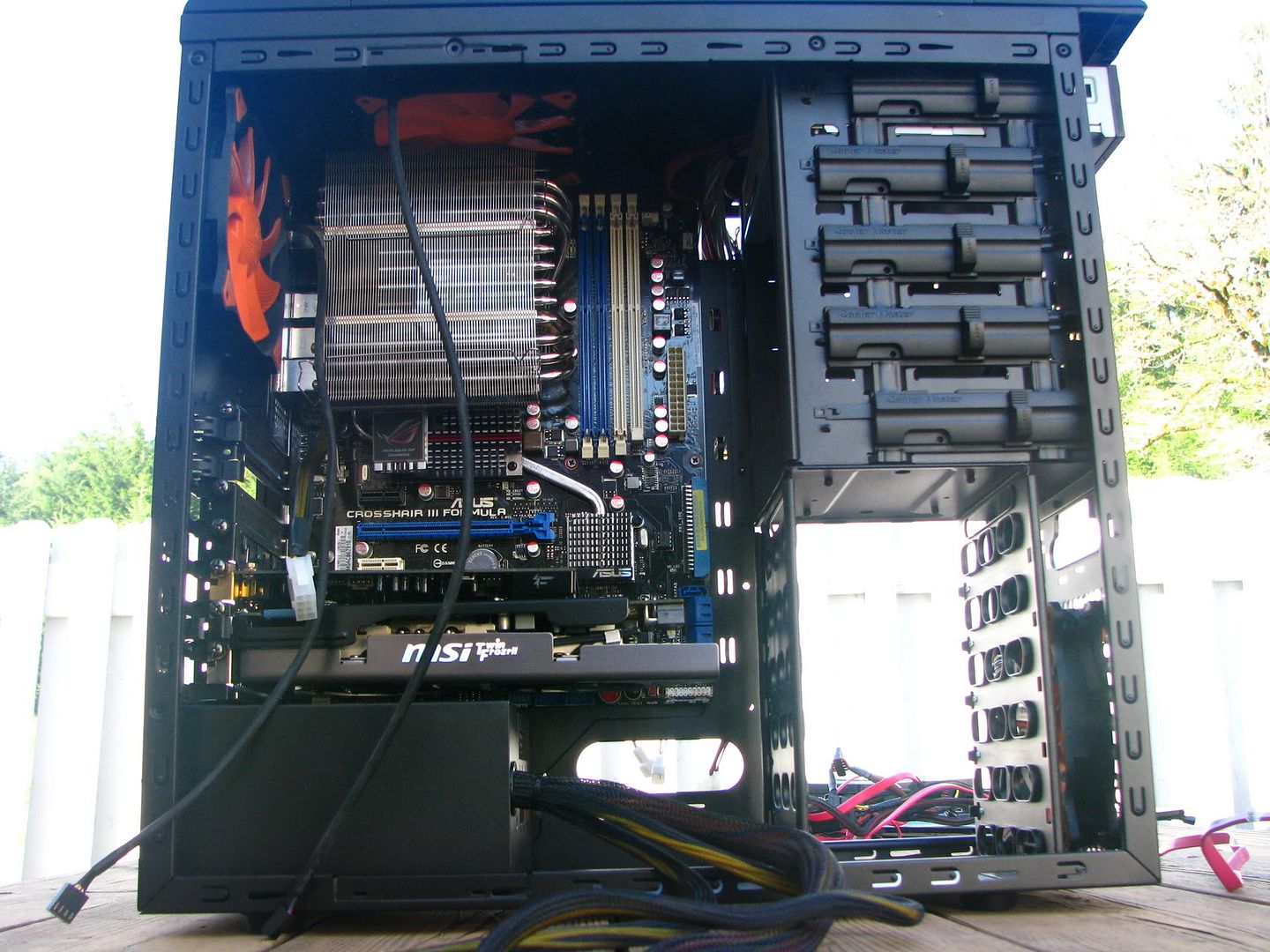

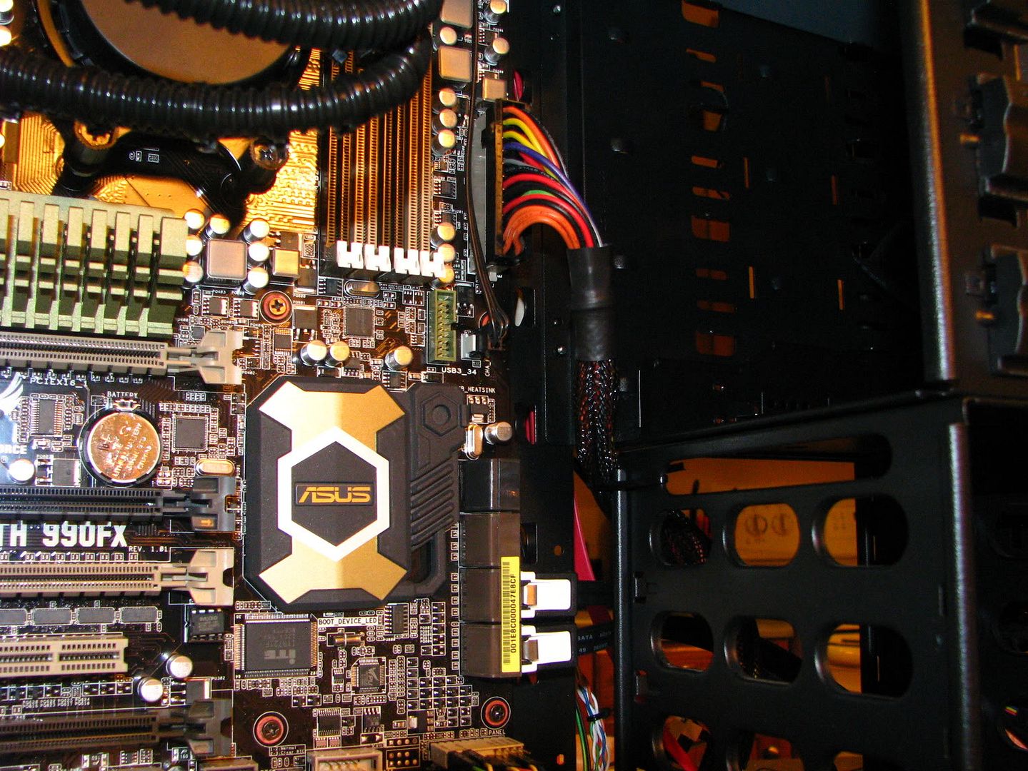

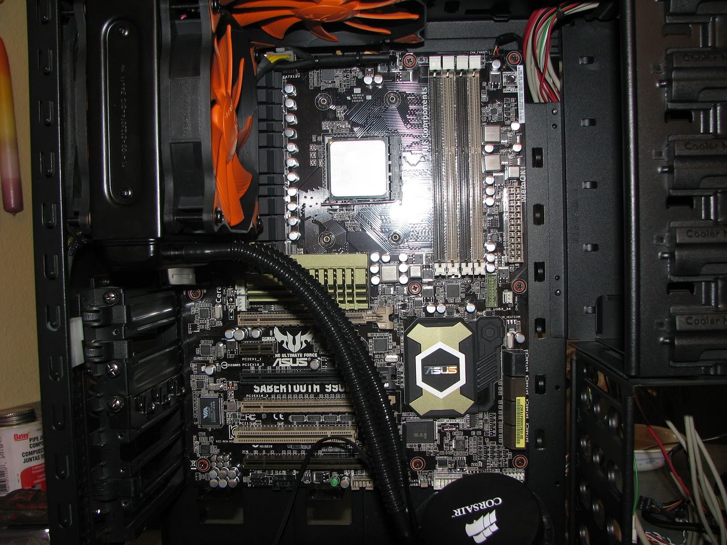

    Routed the 24 pin cable through the side/back of the motherboard/hard drive tray, this is the single hardest cable to route, my case doesn't have enough room behind the full motherboard tray to route it - so I am forced to run it up along the hard drive bay while securing it with zip ties.
    Also have connected all the molex plugs on the bottom half of the motherboard, all USB, HD Audio, and Power/Reset/Activity pins. These were all routed behidn the motherboard tray, and before routing them, I physically took teh cables and bent them at a sharp angle so when they are plugged in, they immediatly get angled off towards the back of the motherboard slot.

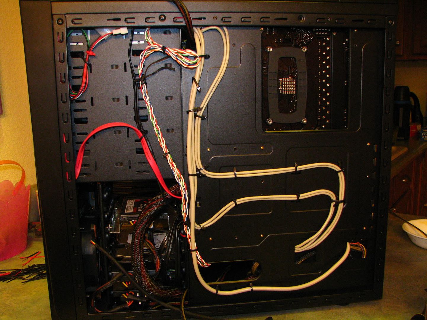

    The back of the motherboard tray. Due to every case in existance having OBSCENELY long USB/HD Audio plugs, you are forced to route them in odd patterns to take up extra slack. Utilizing the back of the tray, and all the extra pin outs for zip ties - you can route it in such a way that all the extra slack is taken up, and you are able to completely hide all of it from the front of the case.

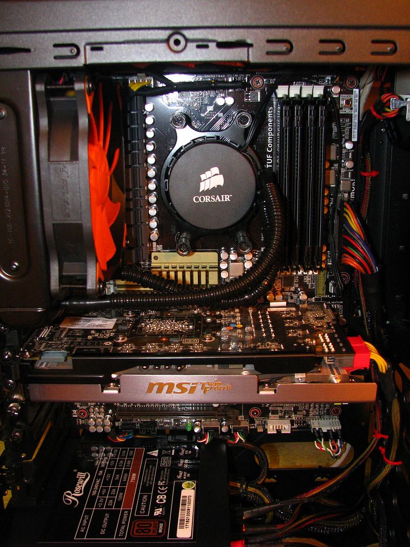

    Plugged the GPU back into its PCIE slot, and ran the pwoer for it. One of the drawbacks of a midtower, again, s that some power cables you can't route. The GPU being one of them, as well as the 24 pin, and sometimes a CD/DVD Sata Power Cable. Tie them off as best as you can, This is just an example of how you can do it. Some cases have much better access for routing cables and those can be pushed behind the motherboard tray with plenty of room in excess.

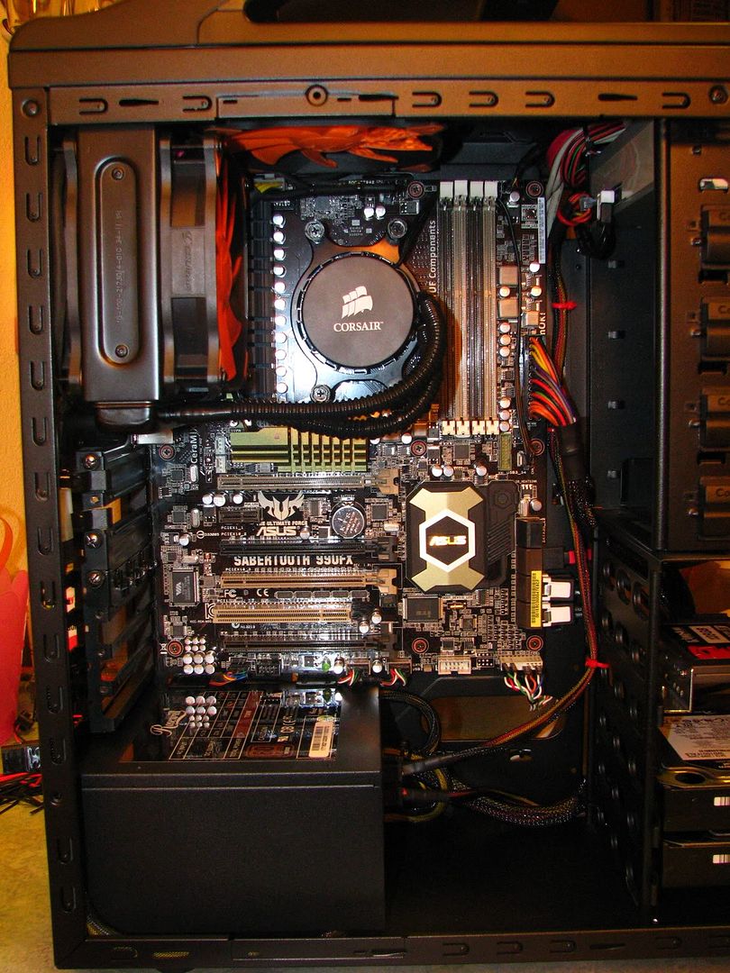

    Seeing as this is just a guide, many people will have differing opinions on what a computer cable management system should compose of. I prefer spending several hours and taking my time doing this, as it keeps your computer case uncluttered, keeps the air flowing.. and in many cases, makes it extremely easy to blow/dust the case off every few months to keep it in top operating condition.
    Take these pictures and use them for a guide on how you wish to route your own cables.. do whatever you can to take advantage of tie downs, zip ties and behind the case space, if you are having a hard time routing cables.. post a picture of it and reply in this thread - there are many of us here who would be more then happy to give you opinions on what can be done to optimize your computer case.
